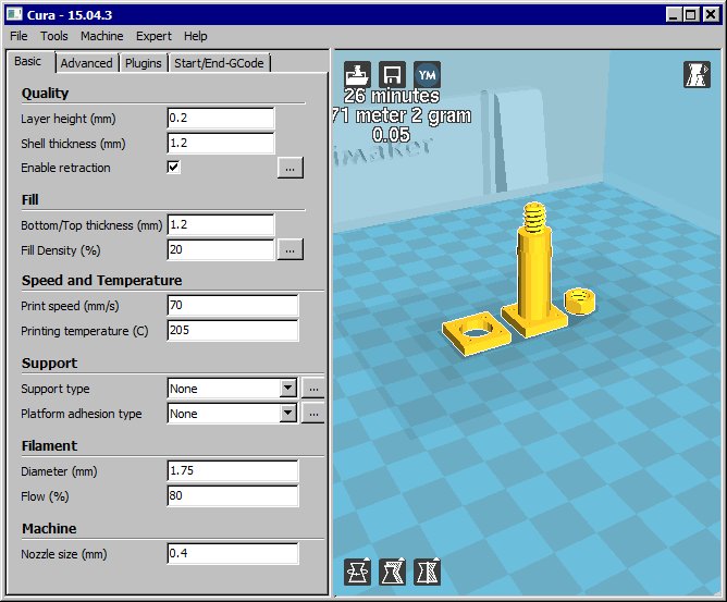

Here are the settings I used:
Welcome new user Branez Denco10
Note that I turn the bed temperature down to 50°C after the first layer has printed. I am also starting to experiment with temperatures and currently printing at 200°C to prevent "stringing".
Has this answered your questions?

Post by Admin on Wed Feb 27, 2019 2:00 pm
Hello again,
The settings look good, but I will check them this evening.
I used 1.75mm PLA, but the nozzle diameter should be selected to suite the nozzle you are using.
I used "raft" and not "brim" when I printed mined mine, mainly because I have an adhesion problem with my printer, and the raft is a workaround.
But I will respond this evening and post my settings page :-)

Welcome new user Branez Empty Denco 3D printed Coils
Post by Branez on Wed Feb 27, 2019 7:39 am
Are these settings with which it is printed? What is the diameter of the nozzle hole? What material do you use, PLA or anything else?
Welcome new user Branez Denco_sub_01a
Try to increase the height of the layer to 0.2mm. So I printed without problems with PLA.
Welcome new user Branez Cura-set
